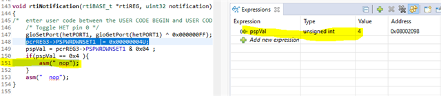

  • I knew you cited this chapter. I just did a test on LC43x HDK, and the PSP power down bit for DCAN2 is set. Here is my test code.
    1. DCAN1 and DCAN2 are connected: 2 nodes CAN network
    2. DCAN1 transmits data using mailbox 1, and the message ID is 0x1
    3. DCAN2 receives data using mailbox1, and message ID is 18 (different from ID of the msg from DCAN1)
    4. RTI compare0 gets interrupt every 500ms. In RTI ISR, set power-down bit for DCAN2 module:  pcrREG3->PSPWRDWNSET1 |= 0x00000004U;
        and read back the value of this register
    5. Run the code and make sure the waveform is correct on oscilloscope, and DCAN1 keeps re-transmit this message (ID=1)
    6. Add breakpoint at asm("  nop"); the code execution will be suspended at this point, check the readback value
        pspVal = pcrREG3->PSPWRDWNSET1 & 0x04 ;
        if(pspVal == 0x4 ){
            asm(" nop");
        asm("  nop");

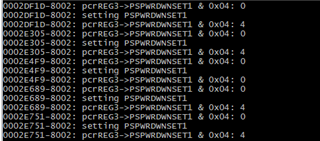

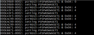

  • Thank you for taking the trouble and setting up a test. Modifying my test closer to yours resulted in a more specific outcome.
    It appears that traffic on the bus is clearing the pcrREG3->PSPWRDWNSET1 bit, and problem with the readback value is a result of that happening during its setting.
    My test steps now look like this:
    1. DCAN1 and DCAN2 are physically connected
    2. Verify DCAN2 is powered down (pcrREG3->PSPWRDWNSET1 & 0x04 is set).
      Log when executed repeatedly:
    3. Start transmission from DCAN1 -> CAN bus under 100% load, enforced by ACK off, confirmed by CAN probe:
    4. pcrREG3->PSPWRDWNSET1 & 0x04 is not set even though DCAN2 was not powered up. Readback when setting it fails around 1 in 4 times.
    5. After disconnecting the cable connecting DCAN1 and DCAN2 and repeat step 4, the bit stays set.

        print("setting PSPWRDWNSET1");
        pcrREG3->PSPWRDWNSET1 = 0x00000004U; // writing zeros has no effect
    print("pcrREG3->PSPWRDWNSET1 & 0x04: %d", pcrREG3->PSPWRDWNSET1 & 0x04); break; } }
    Could you please try reading the "pcrREG3->PSPWRDWNSET1 & 0x04" before setting it in your test too?
    Can you verify the BUS is under 100% load when setting the PSPWRDWNSET1 ? Perhaps deleting lines 118-119 in your example.
