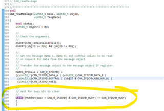

We have noticed that many drivers in driverlib from C200 ware (right now we are using C2000Ware_4_00_00_00) use while loops to wait until a specific register gets a desired value. For example in the CAN driver:
We see this as a risk because a failure in this peripheral could lead to remain in this loop indefinitely and therefore block the whole firmware. My questions here:
