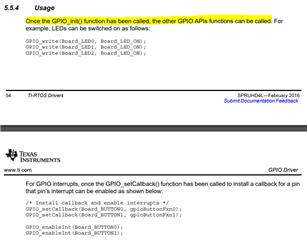

  • Hi Doug,
      In your main(), did you call Board_initGPIO? If you called Board_initGPIO() then it will automatically setup the interrupt vectors for GPIO including PJ and PD and many others. I think your code will interfere the settings that was done by Board_initGPIO().

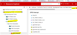

      Please refer to TI-RTOS GPIO Interrupt example. You can import this project into your workspace. This example actually uses PJ0 as a switch to generate interrupt.
    I'm not very knowledgeable on TI-RTOS but this is what I found after tracing the code.
    If you open the gpiointerrupt.c of the project you will see the below snippet of code in the beginning of main().

  • You are correct.  My main has a call Board_initGPIO(); and that calls:
    void EK_TM4C1294XL_initGPIO(void)
          /* Initialize peripheral and pins */
          GPIO_init();
    I can't trace GPIO_init(); back any further that a header in GPIO.h even with the debugger.
    If I comment out the call Board_initGPIO() in main, I can install the IRQ INT_GPIOJ_TM4C129 now.
    Do you know where the source is for the function GPIO_init();?  If I comment Board_initGPIO() out in main, I may be loosing something I need.
    Doug
  • Hi Doug,
      Glad that you are making progress. If you are going to configure the GPIO pins manually using TivaWare (you still need to use Hwi to manage the interrupts ) then I don't think you will lose something by commenting out Board_initGPIO().
      I was able to trace GPIO_init() in the debugger. I just single step and it will take me to GPIO_init(). GPIO_init() is in GPIOTiva.c file which can be found in C:\ti\tirtos_tivac_2_16_00_08\products\tidrivers_tivac_2_16_00_08\packages\ti\drivers\gpio directory.
  • OK, I have the source now.  I had to "brows to the source" but now I can see it in the debugger.  I have one or two more questions.  I now have the IRQ firing using the user buttons on the eval board but I want to be sure I am clearing the IRQ OK so it doesn't keep firing.  I first tried the commented out line "GPIO_clearInt(INT_GPIOJ_TM4C129);"and it crashes when it executed that line of code.  Am I using that function GPIO_clearIn()wrong?   I then found the GPIOIntClear() and the documentation says the second argument in the function is the flags so the flags I used the IRQ number "INT_GPIOJ_TM4C129     =  67 ".  Is that correct the correct arguments for the function GPIO_clearIn()?

  • Hi Doug,
      I think the reason is that you have bypassed GPIO_init() which is called by Board_initGPIO().  Since the GPIO driver has not initialized, you cannot use any GPIO APIs. Refer to section 5.5 for GPIO driver.
