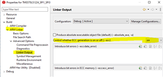

    The CCS and Uniflash support ECC generation:
    By default, the on-chip Flash Plugin erases the flash before programming, generates ECC for the executable and programs it along with the main array flash content and verifies the programmed content. If needed, users can enable blank check - CPU verification to confirm that flash is erased before programming.
    You can use linker cmd file to generate ECC during link step. The –ecc options provided in the link step in CCS has to be enabled. When -ecc is enabled, linker will generate the ECC image for the flash application and append it at the end of the executable. TI flash tools (CCS and UniFlash) are capable of programming this appended ECC image instead of the default generated Auto ECC. When using the linker ECC option, Auto ECC Generation provided in the TI flash tools should be disabled.
