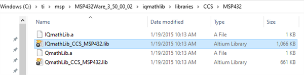

    Yes, I found the same.  I'll have to get with our QMath expert on this one.  In the mean time, you can use the precompiled libraries.  I did on your code and saw no errors.

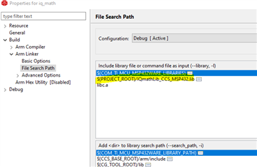

    To test on your side, copy the IQmathLib_CCS_MSP432.lib to your projects top level directory (where you have your main.c) and change your project properties as follows:
