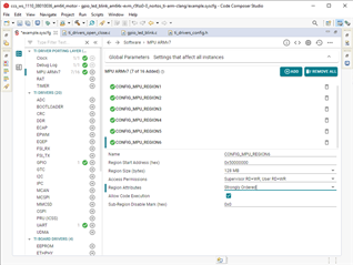

  • Hi Leo,
    In order to access to the 0x50000000 (GPMC memory address space), you will need to add a MPU entry for this region in the example.syscfg using SysConfig. Something like the CONFIG_MPU_REGION6:
    Ming

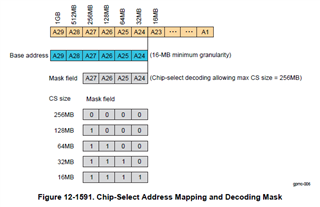

    Thank you for your quick answer. I already added the MPU region. I worked on the problem and I found that the address register was badly configured. For those that might help, here is what I did.
    The register GPMC_CONFIG7_i hold the address that is related to the i (i = [0 3]) memory device connected to the GPMC. There is the MASKADDRESS and the BASEADDRESS. The Figure 12-1591 shows how both are use. Since there is an A0 bit that is not shown in the figure and the base address of the GPMC data region is 0x5000000, the value placed in the BASEADDRESS must be 0x1_ where the _ is whatever you want for the rest of the address. The A29 must be set to 0 and the A28 must be set to 1 since those bits are the A29 and A28 of the data region address (0x5000 0000 = 0xb1001 0000 0000 0000 0000 0000 0000 0000).
    Here is the rest of the code that allowed me to make the GPMC works :
    // Init the GPMC 0 for the DAC
        GPMC0->UNIT[0].CONFIG1 = (1 << 28)  // Enable the write multiple access
                | (1 << 27)     // Select the write synchronous
                | (1 << 24)     // Set the device burst page of 16 words
                | (1 << 12);    // Set the device size at 16 bits
        GPMC0->UNIT[0].CONFIG7 = (0xF << 8) // 16MB mask address
                | (1 << 6)                  // Enable the chip select
                | (0x10);                   // Base address
