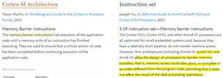

      I don't think it takes multiple cycles for CRC to calculate the checksum. It does look like the optimizer is re-arranging the order of read. Can you show the assembly code?
      Please also find this below article about memory barrier. As it is described, Cortex-M4F is based on Armv7E-M architecture allows processor for out of order memory operation. As far as the processor is concerned, the write to CRCDIN and the read from CRCRSLTPP are two different memory transfers. The read does not depend on the write to complete. Adding a memory barrier instruction or like what you did with a NOP is a correct remedy in my opinion. Please also try to declare the variable volatile.
    https://www.sciencedirect.com/topics/engineering/memory-barrier-instruction
    The register access is already declared as volatile:
    //! \brief Access a peripheral hardware register
    #define M_HWPRegister(peripheral, reg)     (*(reinterpret_cast<volatile uint32*>(static_cast<uint32>(peripheral) + static_cast<uint32>(reg))))
    Code is not re-arranged and instructions are executed in the correct order as you can check in the screenshot below. You can even notice that a BNE instruction is executed between the STR to CRCDIN register and the LDR to CRCSEED register. As adding a NOP instruction added between the BNE and LDR instruction seems to solve the problem, a DSB instruction will most likely work even better but this is still in contradiction with what is mentioned in the datasheet:

    Actually NO it is not the right thing to do, after doing some investigation and modifying my code in order to have a minimum of assembly instruction:
    This fails:
    This works:
    Conclusion, adding a DSB instruction SEEMS to be the right thing to do. At least with this test, as I minimized the number of instructions, it should be enough to justify the workaround in our documentation. But once again, this is the perfect example that assumptions are not enough to solve an issue and I expect from TI to be professional, to perform a clear HW analysis and provide a documentation update which specifies with certitude what is the right thing to do.

    Let's break this up into two aspects here.
    Aspect #1: The intent of the TivaWare API design
    We are not positive on why the TivaWare API was written to make the additional TivaWare API call in the return statement, but it is clearly a departure from how TivaWare is traditionally handled. Hence we suspect but cannot confirm that this was an intentional adjustment to avoid the issue you are seeing. So the 'perhaps' statement is purely regarding past development.
    Aspect #2: The issue at hand and the functionality of the TivaWare API
    What you have presented is a unique case to us. We have not had prior questions regarding this exactly behavior before and no one using the TivaWare API has had an issue like this.
    The issue from what we can see seems to stem from how you are developing your own code at a DRM level. The mismatch between the steps you are taking vs the steps our TivaWare API took is therefore likely introducing this issue unless you are (unlikely) the only customer to use this feature in the past 5+ years.
    Based on the results you are getting with your various tests, it is very clear that additional cycles are needed to get the CRC data updated. Yes, that is a departure from the datasheet, but right now all evidence points to the additional cycles being a requirement to be able to get the data.
    And I do say 'cycles' intentionally as it is clear that a single NOP alone was not enough. The TivaWare API call used introduces multiple cycles and so a single NOP does not fully replicate what is occurring with the proven API. The DSB instruction is working better as it is has the potential to wait additional cycles rather than just a single cycle.
    What you should test as well is using three to five NOPs. I did an assembly breakdown of the proven TivaWare API and it adds minimum 5 additional cycles between the BNE and LDR instructions. What is not clear is how reliable DSB will be to always introduce enough delay - if you want to use it, then make sure to validate that. Otherwise I would recommend ensuring more than 1 cycle is delayed. Minimum of five has been proven to work via TivaWare API but I strongly suspect that three cycles is sufficient based on both my years of experience and the results presented by your evaluations. You could certainly just test the robustness of DSB or even two NOPs but my official recommendation is minimum three cycles of delay and validate that it works properly moving forward.
    To get back to the topic of your confidence in this proposal...
    When looking that the TivaWare API:
    1. Adds additional cycles
    2. Is designed different than other APIs in how it introduces extra cycles
    3. Has not been reported to have issues
    Plus the data you've presented that adding cycles works at an assembly level, it is clear to use as device experts that the datasheet is incorrect regarding the 'as soon as' statement and you will need to introduce additional cycles to ensure you get the result.
    While we don't have the capability to access the design to verify this, I would not say this is a 'perhaps' you need more cycles. It is abundantly clear that it is required and mismatches the datasheet based on the detailed investigation you have done. Therefore our technical recommendations based on our knowledge of the devices are:
    1. If possible, use the proven TivaWare API.
    2. If not, ensure minimum of three cycles are added in between BNE and LDR to allow the result to appear in CRC Seed/Context register and validate that adjustment. To replicate TivaWare API delays, a minimum of five cycles of delay would be needed.
    I understand that is not the same level of certainty as verifying at a design level, but my intent here is for this added explanation gives you more confidence about the proposed solution.
