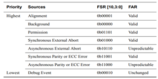

Please check the value of the CP15 Data Fault Status Register (DFSR) to see if it is sync or async abort:
DFSR Register The Figure bellow shows the DFSR register bit assignments:
Use the “S” Bit [10] and “Status Bits” [0:3] to understand the nature of the Data Abort. See Table below for status description:

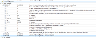

In CCS->View, open "disassembly" window, type 0xEDEC, the window will show the instruction at this address.
The status is b00001, which means alignment fault.
Any unaligned access to Device or Strongly Ordered memory generates an alignment fault. For example, a load of a word (32-bit) from Strongly Ordered or Device memory addresses 0x1, 0x2, 0x3, 0x5, 0x6, or 0x7 generates an alignment fault.
