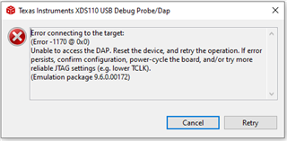

However, when debugging a few simple lines of code, the following errors are being presented:
Dap: Error connecting to the target: (Error -1170 @ 0x0) Unable to access the DAP. Reset the device, and retry the operation. If error persists, confirm configuration, power-cycle the board, and/or try more reliable JTAG settings (e.g. lower TCLK). (Emulation package 9.6.0.00172)
More details of the errors in the following figures:

  • Hi Alex,
    Please try this procedure to let CPU enter a debug state:
    1. Open the target configuration window, and launch the selected the configuration
    2. Switch to debug window.
    3. Press the reset (nRST) button and hold it.
    4. Click “Connect Target” immediately after you release the nRST button.
    5. The board should be connected after couple tries.
