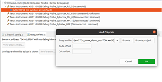

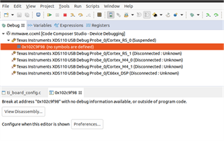

    3) Then load the mmwave_mcuplus_sdk_04_02_00_02/ti/demo/am273x/mmw/am273x_mmw_demo_mssTDM.xer5f file into memory:

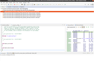

    The code is located at the 0x0000000 address,  and the corresponding function is Board_deinit, as shown below:

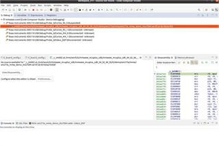

    For the single step mode, they've debugged one step, as shown below:
    No source available for "_c_int00() at /mnt/work/ti/mmwave_mcuplus_sdk/mmwave_mcuplus_sdk_04_02_00_02/ti/demo/am273x/mmw/am273x_mmw_demo_mssTDM.xer5f:{3} 0x102aa7e4{4}"
    And it reports No source files are available, the customer would like to know how to set the breakpoint to the main function in the mms_main.c file and then do a single step debug?

    Breakpoints can be set in the disassembly window (in CCS use view->disassembly) and search for any function name to set the breakpoint.
    CCS target configuration itself can also be programmed to pause directly at main. You can right click the target configuration file ->Properties->auto run and load, and set the "run to symbol field" to main.
    Also, in case CCS is not able to automatically find the source file, the "locate file" button can be used to manually point CCS to the source file where a particular function exists.
