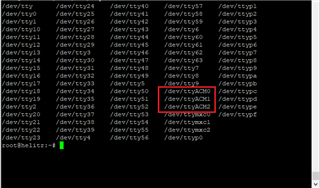

We use TM4C123GH6PM in our project. We would like to use 3 serial ports. Using usb library, in windows 7 and 10, we create 3 different com ports. However, in ubuntu 16.04 we see only one ACM (ttyACM0). ttyACM1 and ttyACM2 do not show up. The followings are reported:
usb 2-1: Product: Virtual COM Port
usb 2-1: Manufacturer: Texas Instruments
usb 2-1: SerialNumber: 12345678
cdc_acm 2-1:1.0: ttyACM0: USB ACM device
cdc_acm: probe of 2-1:1.2 failed with error -22
cdc_acm: probe of 2-1:1.4 failed with error -22
usb 2-1: USB disconnect, device number 3
How can we solve that problem?

  • Hello Ralph,
    Thank you very much for your detailed answer. I solved the problem. I am sharing the solution so that other users can benefit:
    I was using the library of TivaWare_C_Series-2.1.1.71. I changed it with the library of TivaWare_C_Series-2.2.0.295 which includes driverlib, inc and usblib folders. In order to do that:
    1) I downloaded SW-TM4C-USBL-2.2.0.295.exe from TI website and installed it.
    2) I put rvmdk folder of TivaWare_C_Series-2.1.1.71 including usblib.lib into my project folder.
    Thus, I can open 3 serial ports on ubuntu 16.04.
    Thank you very much.
    Best Regards.
    Tufan Erkınacı
  • Hello Tufan,
    Ahh I should have asked if you were using the latest SDK. That makes a lot of sense, I had fixed a USB library bug from prior versions that impacted the ability to properly enumerate multiple USB CDC ports. I am very surprised it worked in Windows 10 - in the past Windows 10 also did not properly enumerate the multiple ports with versions of TivaWare before 2.2.0.295. Very curious. But glad you got it working with the latest libraries.
