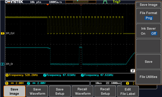

Our requirement is to send 24 bit data and read back 32 bit data continuously, i.e. we need to generate 56 clock pulse continuously. Is there any way to generate 56 clock continuously.
Please see the image attached below.
the above mentioned image is our requirement.
We tried to capture the data transmission in oscilloscope but we are receiving 24 clock pulse alone. i.e. we are not getting the clock continuously.

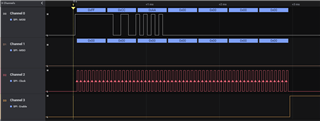

    So I don't easily have a way to test if this works exactly as intended but I believe the way to make this work would be to send your 24 bytes of data and then send four dummy reads of 0x00 to trigger clock cycles before doing the Frame End:

    This generated enough clock cycles for your use case:
    Let me know if that resolves your issue.
