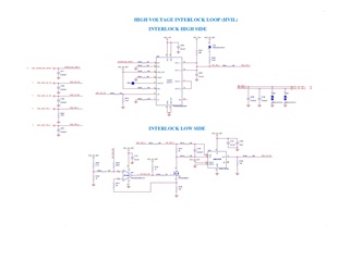

We are implementing High Voltage Interlock Loop in one of our Automotive Project. We have considered Part TPS2H000BQPWP for Interlock High Side. Please find below the Schematic for your reference.
For Design reference, we are considering this TI Document https://www.ti.com/lit/ug/tidud43a/tidud43a.pdf?ts=1648610892346
All the Step we have followed the same as mentioned in the document, When Int_Pin_1 and Int_Pin_2 are shorted we are unable to get the similar ADC_HS_CS Signal as shown in the image below. Rest other signal we got same when given the similar input signal as INTERLOCK_INPUT at the input Pin IN1 as shown in the TI document.
The Input is fed from MCU Pin No : 92 (N2HET1[26]) & ADC_HS_CS is received at MCU Pin No : 83 (AD1IN[8]/AD2IN[8])
