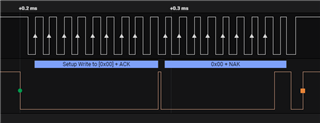

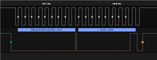

I also used a logic analyzer to see what's going on at every step.
On step 1, it sends the device address 0x00 and receives a positive acknowledgement (it should not) and sends the data 0x00 receiving a negative acknowledgement. This still wakes the device up.
On step 2, it sends the data buffer to 0x36 address of the device and microchip sends an ACK. However, the TPR12 still says it didn't receive an a acknowledgement as it gives -3 error code.
On the last step, it writes 0x00 to the address 0x36 and receives the data from the microchip but does not give an ACK back on the last byte.

    I performed 2 tests. In the first test, I repeated exactly what I was doing earlier.
    For the first part, it sends 0x00 to the address 0x00. TPR12 should receive a negative acknowledgement in the end as is shown in the logic analyzer.
    However, it prints out I2C_STS_SUCCESS ("1") which it shouldn't.
    For the second part, I send a data array (0x03, 0x07, 0x30, 0x00, 0x00, 0x00, 0x03, 0x5D) to the device address (0x36). As expected, it sends the data and receives a positive acknowledgement. TPR12 also gives out 1 as the return status.
    Lastly, I try to read data from the address 0x36. It receives the data but does not send an ACK back to microchip for the last byte.
    However, as a return status it prints out 1.
    Here are the three return statuses. (Please ignore the 4th one).

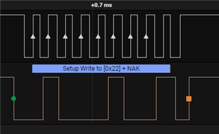

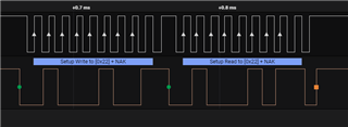

    For my second test, I modified the slave address to be 0x22 so that I know for sure that it returns NACK. My observations are as follows:
    For the second part, I send a data array (0x03, 0x07, 0x30, 0x00, 0x00, 0x00, 0x03, 0x5D) to the device address (0x22). As expected, it does not send the data since 0x22 address does not exist on the bus. TPR12 also gives out -3 as the return status.
    Lastly, I try to read data from the address 0x22. Again, as expected I read nothing since 0x22 address does not exist on the bus. TPR12 again gives out -3 as the return status.
    This makes me believe that current configurations make the return status as I2C_STS_SUCCESS as long as even a single byte is acknowledged during the entire transaction.
