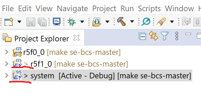

I created two projects and one system project. Their operation seems okay but I found "?" and ">" icons on the added projects as below. Could you let me know what it means?

They are Icon Decorators which show the state of files in a Version Controlled project. If you look at the Icon Decorators is the CCS properties there is a description of what the different icons mean:
