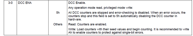

TMS570LC4357: DCCGCTRL register query in PLL
Part Number: TMS570LC4357
While trying to enable the counters while setting up DCC1, by writing 0xAh to the DCC_ENA field of the DCCGCTRL register, it is read as 0x5 only. It was disabled while setting DCC1 and was read as 0x5. While the bit field should be read 5 only when counters are disabled as per the manual (snapshot attached). Request you to provide clarity on the same.
