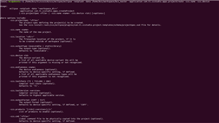

  • Hi the command is working but it is not importing , is there a command for importing then using this command for building?
  • Hello I have used " bcs@ubuntu:~/workspace/bcs_master$ eclipse -noSplash -data /home/bcs/workspace/bcs-master -application com.ti.ccstudio.apps.projectCreate -ccs.name -ccs.device" and also..
    "bcs@ubuntu:~/workspace/bcs_master$ /home/bcs/ti/ccs1110/ccs/eclipse/eclipse -noSplash -data /home/bcs/workspace/bcs_master -application com.ti.ccstudio.apps.projectCreate -ccs.name -ccs.device"
    Both these seems to not work. Giving me same errors as the previous commands did.
    These commands are INCORRECT. Both -ccs.name and -ccs.device require additional parameters. Please see:
    https://software-dl.ti.com/ccs/esd/documents/ccs_projects-command-line.html#create-a-ccs-project
    The above command is also for CREATING a project
    I am confused as to your use case. What exactly are you trying to do? Are you trying to CREATE a NEW project from the command line? Or are you trying to IMPORT an EXISTING project into a workspace?
  • Trying to Import an Existing project into a workspace and build it.
    This is the command you need:
    https://software-dl.ti.com/ccs/esd/documents/ccs_projects-command-line.html#import-an-existing-ccs-project
    <CCS INSTALL DIR>/ccs/eclipse/eclipse -noSplash -data /home/bcs/workspace/bcs_master -application com.ti.ccstudio.apps.projectImport -ccs.location <full path to project folder> -ccs.copyIntoWorkspace
    the last argument (ccs.copyIntoWorkspace) is optional. It is if you want to physically copy the project into the workspace folder. That is up to you.
