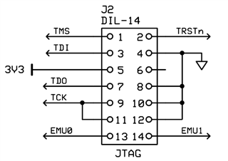

I have few queries related to XDS110 to be used with TMS320F28065 Processor Board We are developing for ECU.
We are developing one ECU using TMS320F28065 microcontroller. While making the PCB, I want to keep a debug connector available on this PCB so that in future I should be able to connect XDS 110 probe to this connector for debugging. My problem is I am not able to find the CAD details of the debug connector from XDS110 side.
Yes, I need help about debug connection too.
I understand that there are two connectors on XDS, one 20 pin debug and second 14 pin aux, I want to understand which exactly to be used for debugging and flashing.
