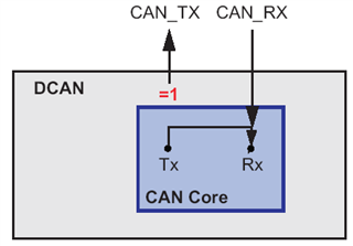

Hello, we are working on DCAN implementation in the LAUNCHXL2-RM46. We tested the Loopback mode and the LoopBack Combined with Silent Mode properly (Attached I send the signal seen from the Tx Port). However, the implementation of silent mode test and not test mode by the connection between Tx and Rx are not working. It seems that the Rx pin is not connected to the peripheral because when using it, we have not seen any type of information in the RAM either signal on the signal analyzer. We tested these configurations with DCAN1 and DCAN2 (canInit function attached here) and we obtained the same response.

  • However, the implementation of silent mode test and not test mode by the connection between Tx and Rx are not working.
    Silent mode is one of the test modes. For all test modes, the Test bit in the CAN Control Register needs to be set to 1. This enables write access to the Test Register.
    Silent Mode is activated by setting the Silent bit in Test Register to 1.
    So using Silent Mode requires that both the Test bit and the Silent bit are set.

    Yeah, we are using a function that changes the TEST bit in the CTL register and setup the Silent mode pin in the TEST register. However, this specific configuration (silent mode) is not working. Information is not in the RAM or even in the physical pin. Other test configurations are working properly. The problem is related to the connection between the peripheral and the physical pin.

    We have done test with L_back without problems. However, we want to know if as datasheet mentioned, it is possible activate silent mode without L_back, because we dont have response in Rx.
  • Hi Daniel,
    The Silent mode is that the TX pin is internally wire-and with the RX pin while driving only recessive bits on the TX pin. The DCAN is still able to receive valid data frames and valid remote frames, but it will not send any dominant bits.
    You are right. If loopback mode (LBK+Silent) is not enabled, you won't get RX interrupt and data because it doesn't transmit any valid data.
  • Ok, perfect
    Thank you QJ. I think that now we can continue with our project considering this information.
