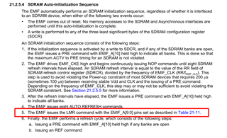

To configure SDRAM, the device supports SDRAM Commands configuration as per the manual:
And the SDRAM initialization process:
The EMIF driver is generated by HALCogen and the Load mode register is not configured. The customer would like to know how to configure the Load mode of SDRAM.

  • Hi Cherry,
    The SDRAM initialization sequence (step1 to step 6) is triggered by writing the least 3 bytes of SDCR register (page size, bank, ..). You don't need to issue LMR command, PRE command manually.
    In HALCOGen EMIF initialization code (emif_SDRAM_StartupInit()):
    emifREG->SDCR = (uint32)((uint32)0U << 31U)|
                                    (uint32)((uint32)1U << 14U)|
                                    (uint32)((uint32)2U << 9U)|
                                    (uint32)((uint32)1U << 8U)|
                                    (uint32)((uint32)2U << 4U)|
                                    (uint32)((uint32)elements_256);
    will trigger the SDRAM initialization (step 1~step 6).
