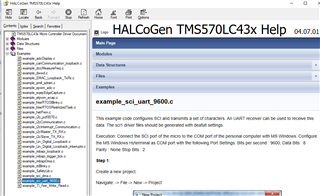

    Please try the examples in HALCOGen:

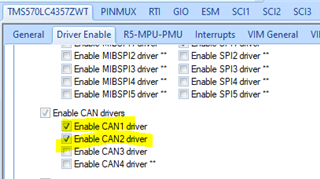

    1. Enable CAN driver: CAN1 and CAN2

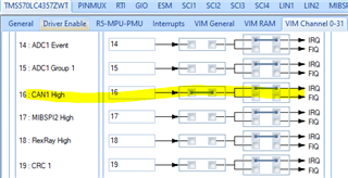

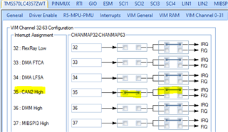

    3. Enable CAN interrupts in VIM:
