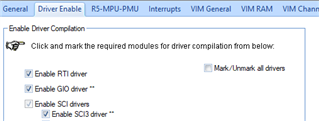

I need to create a RTI for runnable function inside the UART bootloader.
I have enabled the RTI driver ,  VIM Channel 0-31 as RTI Compare 1 is enabled , RTI Compare Compare 1 period as 20.000 ms .
initialization calls in main file
rtiEnableNotification(rtiREG1,rtiNOTIFICATION_COMPARE1);
_enable_IRQ_interrupt_();
rtiStartCounter(rtiREG1,rtiCOUNTER_BLOCK1);
RTI Notification function is created, but I didn't get any notification in rtiNotification in UART bootloader code

  • Hi QJ Wang,
    RTI is configured in HalCoGen for compare 0 and Counter 0 as per your previous reply.
    RTI Compare 0 is set
    RTI Compare 0 is enable for interrupt
    RTI driver is selected.
