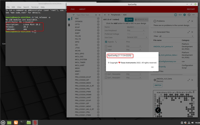

  • Hello Andreas,
    I just installed a fresh Mint 20.2 VM and then immediately installed standalone sysconfig 1.11. It seems to work fine for me. Hence it appears to be an issue with your local environment.
    If you have CCS installed on your machine, can you open a syscfg file in CCS? Can you provide a screenshot of the blank sysconfig tool?

  • Thank you for the additional data. Perhaps there is some conflict with other additional packages installed that is common with both you and your colleagues machines. As mentioned in my earlier post, a fresh mint 20.2 install followed by a sysconfig 1.11 install seems to be ok:
    I will try updating my mint installation and also follow up with the sysconfig engineers to see what could be the issue on your end.

    Engineering found some unusual information in your logs but still do not have enough information to determine the root case. They are suggesting a webex meeting so they can observe the issue on your environment. If this is fine, please let me know of your availability next week so that I can coordinate with engineering. Please start a private E2E conversation to discuss further.
    ki
  • This issue was resolved via private message. For those following this thread, the root cause was a conflict between a library used by Citrix and node webkit (used by SysConfig). Updating to the latest version of Citrix resolved the issue.
    ki
  • addidional information:
    From TI: Your version is loading /usr/local/lib/AppProtection/libAppProtection.so which has been flagged online as creating similar problems in vscode and firefox which are both browsers. Can you try temporarily moving this file and see if that helps? If may require updating LD_PRELOAD or LD_LIBRARY_PATH to remove anything that depends on it
    Citrix uses this library and some other apps also had trouble with it. Uninstalling icaclient (Citrix) helps. A newer version of citrix workspace app was released on 11.5.2022 for linux. This version seems fine. Sysconfig was able to start and show something.
    Also, there may be an configuration possibility in citrix workspace app which gives possibility to install without AppProtection. Did not see this.
