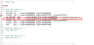

   My goal is to place a volatile const uint64_t variable at specific FLASH address (GOLDEN_CRC area, address 0x001FFFF8~0x001FFFFF).

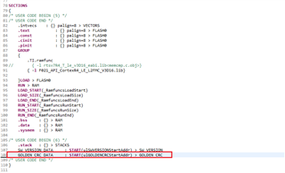

My cmd file design as following:

My question is that the HEX file is not as the above, the HEX is as following:
just 16bit contents are in HEX(bit0~bit7, and bit32~bit39 of #define).
I tried several define-value tests, proved that only bit0~bit7, and bit32~bit39 of define-value is reflected in HEX file.
