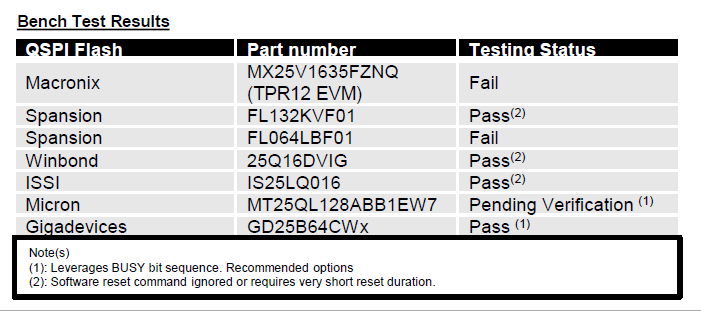

AM2732: Can AM2732 RBL support IS25LP032D-JTLA3 ?
Part Number: AM2732
Other Parts Discussed in Thread: AWR2243,
    My customer would like to use IS25LP032D-JTLA3. According to QSPI Flash Compatiblilty with ROM Errata-v3.pdf in EVM design package, we can support IS25LQ016.
Flash vendor confirm the difference between is two are DEVICE ID and Size of Flash. So I would like to double confirm if our RBL can support IS25LP032D or not since DEVICE ID is different.
