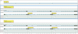

    2. Is it correct that the addresses appear on the bus as GPMC_AD(a) (image below)?

    2. No I think the address should come out like the GPMC_AD(b) picture. A different address appears at the beginning of each GPMC burst.
