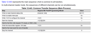

finally I repeated my test with channel 0 and got the same result like before with channel 2:
Setting CHCTRL.EN bit produces rising of CHSTAT.TXS bit and the corresponding IRQSTATUS.TXn_EMPTY bit when MODULCTRL.SINGLE = 0.
TXS bit does not come when SINGLE = 1.
Why?
Regards, Kalman

  • Hi Sunil,
    sorry for my late response.
    We are using SPI memory device and two shift register chains connected to SPI port of Sitara and I went down to registers and bits to produce effective code. I have learned in last 40 years that it is advisory to check the availability of the output register before writing a new value. This is the TxEmpty bit in this case. I have made a low level SPI EEPROM driver in single mode and used the TxEmpty bit according to practice. Next task was to drive the shift registers, two channels in master mode ==> MODULCTRL.SINGLE = 0. I was happy to get hardware driven chip select signals. I reused my single master code & knowledge at first and was surprised that TxEmpty is not set after channel enable in multi channel mode. I am ready with my code, it is OK. I am just wondering at this funny behavior of TxEmpty.
    SPRUIM2C page 5502 suggest wait for TxEmpty after channel enable even in muli master mode:
    Regards, Kalman

  • Hi Kalman,
    I checked the below driver example and updated the mode of operation to "multi master" in syscfg gui
    examples\drivers\mcspi\mcspi_loopback\am243x-evm\r5fss0-0_nortos
    In the function MCSPI_masterIsr, put a break point and taken the register dump and I am seeing the TX0 Empty in irq status is set and also the TXS in the CHSTAT is also set.
