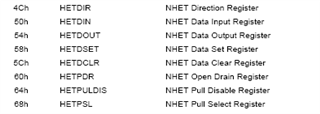

For the GIO of the GIO Module the data in and data out registers can be read back. both registers need to have the same value.
(Q2) So at boot and periodically we should check, that the registers of every Pin match correct?
(Q3) Is there a way to achieve a similiar thing for other modules used as GIO (e.g. N2HET)?
(Q4) If we wanted to check the data in and data out register directly after toggeling a Pin, can for example a capacitor lead to data in and data out register not matching because of the delay added by the capacitor?
    Yes, same as GIO module.
