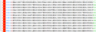

Hello TI engineer:
I found the CCS generate the fix data length of intel(0x20) hex or motorola s-record.
How to generate a HEX with specific longer data length?
INTEL HEX example (0x20)
Motorola S-Record
Hello TI engineer:
Motorola S-Record
Hi Xi,
Please read this help file:
I don't think the byte count for each line is configurable in HEX utility.
