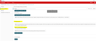

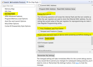

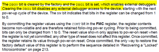

I am trying to program tm4c129x microcontroller with xds110 and its showing this errror CORTEX_M4_0: Trouble Halting Target CPU: (Error -2062 @ 0x0) Unable to halt device. Reset the device, and retry the operation. If error persists, confirm configuration, power-cycle the board, and/or try more reliable JTAG settings (e.g. lower TCLK). (Emulation package 9.3.0.00032).
I think the problem is with code only. I did some change in my code and upload it and after that its showing that error.
