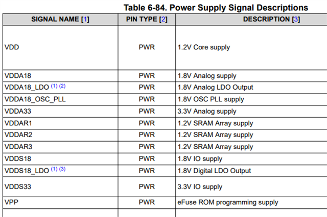

I have already checked the discrete power tree implemented in theTMDSCNCD263 Control card (TPS54334 for 3.3V, TPS62826 for 1.2V, 1.8V seems to be internally generated by the AM263x).
Would the TPS62442-Q1 (Dual-channel DCDC) be suited to power the 3.3V and 1.2V power rails?

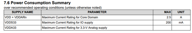

    If not, I have checked the different power consumptions in Am263 (Datasheet):
    Here, we have VDDAR (1.2V) and VDD (1.2V) need maximum 2.5A. And VDDS (3.3V) need maximum 200 mA.
    For the  TPS62442-Q1 (Dual-channel DCDC), you have shared, the current and voltage specs are as below (datasheet):
    Input and Output Voltage Ranges:
    Here you can consider the input, output min and max voltages. TPS62826  also has input voltage range of 2.4-V-5.5-V. Hence, 6V max input should be okay.
    Here, the 3A and 1A combination can be used for 1.2V and 3.3V power rails.
    So this TPS62442-Q1 should be suitable for the AM263.
    Please share us your inputs as well. Are these current requirements suitable for you?
