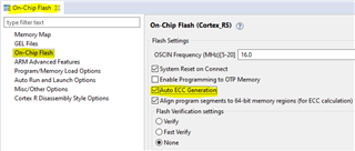

TMS570LS3137: CLion integration
Part Number: TMS570LS3137
Other Parts Discussed in Thread: UNIFLASH, , HALCOGEN
I am trying to integrate TMS570LS3137 development with CLion, because using any Eclipse-based IDE drives me crazy. I've managed to create CMakeLists.txt based on CCS generated Makefile, application builds and links successfully (this is what CLion is saying), however it is not working - nothing happens after flashing generated .out file with Uniflash, moreover, after power cycle, red ERROR LED is on (on HDK). Same application built with CCS works as intended. I am attaching my sample project, it can be opened both by CLion and CCS. I will be grateful for any help, I am struggling with this problem for two days.
led-blinky.zip
  • Hi Bartosz,
    Does CLion use same ARM compiler and same compile/linker settings used by CCS11?
  • Hi QJ Wang,
    yes, CLion points to the same TI CGT ARM compiler, however I had to create custom compiler (please check attached custom_compiler.yaml file). Generated Makefile flags are as follows:
    -mv7R4 --code_state=32 --float_support=VFPv3D16 -g --diag_warning=225 --diag_wrap=off --display_error_number --enum_type=packed --abi=eabi -z -m"led-blinky.map" --heap_size=0x800 --stack_size=0x800 -i"/Applications/ti/ccs1110/ccs/tools/compiler/ti-cgt-arm_20.2.5.LTS/lib" -i"/Applications/ti/ccs1110/ccs/tools/compiler/ti-cgt-arm_20.2.5.LTS/include" --reread_libs --diag_wrap=off --display_error_number --warn_sections --xml_link_info="led-blinky_linkInfo.xml" --rom_model --be32 -o "led-blinky.out" $(ORDERED_OBJS)
    CLion uses CMake, so compiler and linker phases are a little more separated, but I think I copied them accurately:
    add_compile_options(-mv7R4 --code_state=32 --float_support=VFPv3D16 -g --diag_warning=225 --diag_wrap=off --display_error_number --enum_type=packed --abi=eabi)
    include_directories(include user)
    include_directories(${TOOLCHAIN_PATH}/include)
    include_directories(${TOOLCHAIN_PATH}/lib)
    add_link_options(--stack_size=0x800 --heap_size=0x800 -i${TOOLCHAIN_PATH}/lib -i${TOOLCHAIN_PATH}/include --reread_libs --diag_wrap=off --display_error_number --warn_sections --xml_link_info=led-blinky_linkInfo.xml --rom_model --be32 ${CMAKE_SOURCE_DIR}/source/sys_link.cmd -l${TOOLCHAIN_PATH}/lib/rtsv7R4_T_be_v3D16_eabi.lib)

  • Hi Bartosz,
    Don't you program the ECC?
    The CCS has one option to generate ECC when loading the code to flash.
  • If Clion doesn't support "Auto ECC Generation" when loading code, you can use linker cmd to generate ECC for your code.
    Please refer to this app note:
    https://software-dl.ti.com/hercules/hercules_docs/latest/hercules/How_to_Guides/HowToGuides.html
  • Here is my example of ECC generation using linker cmd file for TMS570LS31x device:
    https://e2e.ti.com/cfs-file/__key/communityserver-discussions-components-files/908/8037.sys_5F00_link.cmd
    To enable the ECC generation, please add the flag below to your link command:
     --ecc=on
