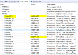

My customer found a board and run the attachment code. The count is always reset to 0 when count to 0x200.
It only happens on one board and issue follows with TM4C129 after ABA swap.
2022/05/03 17:11:12.176 ==>> Get RTC: 000001FF
2022/05/03 17:11:13.225 ==>> Get RTC: 00000001

  • Frank,
      Can you observe HIB_RTCC and confirm that after 0x1FF it is rolled over to 0x1 again?
  • hi Charles,
    Yes, as my first post.
    I read the HIB_RTCC by using HibernateRTCGet().
    On issued IC, it always return to 1 as below.
    BR,
    frank
  • Hi Frank,
      I understand that you read a 1 by calling HibernateRTCGet(). I'm asking if you monitor the register window for HIB_RTCC register, do you see that it rolls over from 0x!FF to 0x1. You need to set the register window to "continuous refresh".
  • hi Charles,
    from memory, it still roll over from 0x200 to 0x1. any suggestion?
    BR,
    frank
