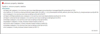

    I did notice that when I update the AM243x SDK in CCS from 8.1.0.36 to 8.2.0.31, I get the following error in the example.syscfg file, and when I click "Go Back" I end up having to reconfigure my sysconfig settings the way they were before.
    I noticed that when I when configuring the MCSPI in example.syscfg in SDK 8.1.0.36, under MCSPI Channel Configuration, there is a field for Data Frame Size (bits) which I have set to 32. But when I'm configuring the MCSPI in example.syscgf in SDK 8.2.0.31, I don't see Data Frame Size as a field to set. I've attached comparison photos below.
    Could this cause issues? Do you know where I can set this value using v8.2.0.31 of the SDK?

  • Hi Jesse,
    You are correct. The way MCU+ SDK handles data frame size in 08.01.00.36 and 08.02.00.31 is different:
    08.01.00.36:
    Sysconfig set Data Frame Size to  gConfigMcspi0ChCfg[0].dataSize,
    then it passed to dataWidth with "dataWidth  = gConfigMcspi0ChCfg[0U].dataSize;" when  MCSPI_setDataWidth(baseAddr, chNum, dataWidth) is called.
    08.02.0.31:
    dataWidth is set to 32, when  MCSPI_setDataWidth(baseAddr, chNum, dataWidth) is called.
