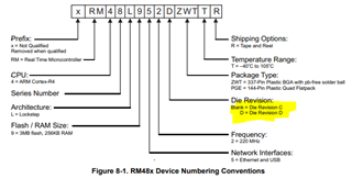

Hi team,
May I ask that what is the different between RM48L952ZWTT and RM48L952DZWTT?
Thank you!

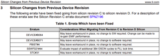

Could the customer change from RM48L952ZWTT to RM48L952DZWTT directly?
Does the Silicon Changes from Previous Device Revision section in RM48x Microcontroller Silicon Errata (Silicon Revision D) (Rev. B) answer the customer's question?
