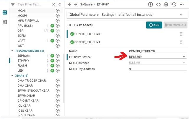

    Q1) I can find the DP83826E driver source file in AM243x SDK as well. However, it is not shown in syscfg. When I checked this in AM263x, both DP83826E and DP83869 are shown in syscfg.
    Can you let me know how to make DP83826E to be shown in syscfg with AM243x SDK?

  • Hi
    You will have to update the .js files for SysConfig. I can share the steps if you are okay with making that change.
