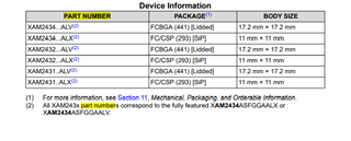

P.S. I am working on an AM243x, I thought, my part number was XAM2434ASFGGAALV .
as it says in the AM243x-datasheet:
But it is not accepted.
