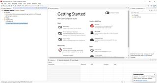

I had tried to work with a sample project HalCoGen and CCS but there is no source code linked between them.
Please kindly advise.

HI Sanon,
Where did you get this HAL example project?
I have uploaded two examples (project 0 and project 1) to the link below:
https://software-dl.ti.com/hercules/hercules_docs/latest/hercules/Examples/Examples.html
Click "commit", you will see the zip file. The click the zip file link to download the file.
