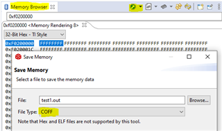

    5. can you save FEE memory content (in COFF format) and share with us?

    5. Since we have used the TI_Fee_ErrorRecovery() and recovered form the error - the states of the VS are proper now.
        Do you still want the Memory log ?
  • I don't know what causes this error. Since the issue has been resolved, you don't need to upload the memory content. Thanks.
