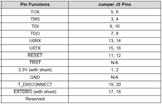

Currently, the J3 connector mounted on the DK-TM4C129X is used, and a 10P flat cable is used to connect to an external device.
The pin number used for connection is 1/3/5/7/9/11/13/15/17/19.
(The table below is the pin table of the J3 connector of DK-TM4C129X, which is taken from the user's guide.)

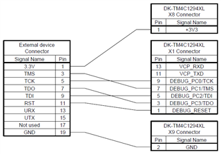

The conditions that cannot be changed are as follows.
- The pinout of the external device cannot be changed from now.
- You must also use the 10P flat cable you are currently using.
How can I connect to the EK-TM4C1294XL from the above conditions?
Do you need any additional devices?
