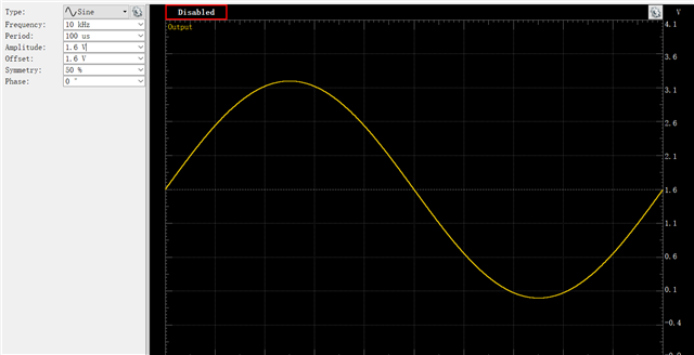

A 10kHZ sine signal is connected to PE3.
The Init settings  is shown below and i'm quite sure that these peripherals are initialized in the main function in a proper order.(CLOCK->GPIO->ADC->Timer)

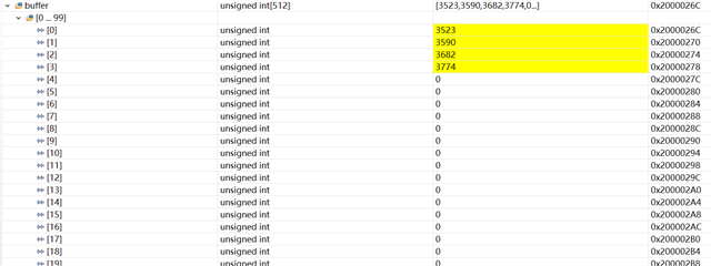

In my opinion i have have 4 new data when an interrupt occured.
When first interrupt occured:
When second interrupt happend:
Does it mean that i should configure the ADC sequence step again in the interrupt handler?
Or there is something wrong in the  initial setting?
I don't understand this situation since i just try to get 4 new data every time.

  • Hello Yang,
    I've found the issue now - the speed of your sampling versus the speed at which your ISR is able to enter and store the data is causing the ADC sequencer to overflow.
    This code proves that out:
        uint32_t adcbuf[6] = 0;
        // uint32_t j,sum=0;
        ADCIntClear(ADC0_BASE, 0);
        if (ADCSequenceOverflow(ADC0_BASE, 0) == 0)
            ADCSequenceDataGet(ADC0_BASE, 0, adcbuf);
        else
            ADCSequenceDataGet(ADC0_BASE, 0, buffer);
    After the first sequence triggers where I got the correct output - then every other interrupt went into the else statement for an Overflow occurring.
    With the sample rate configured, you probably will want to use the DMA to fill a buffer like our adc_udma_pingpong example because this way you can receive a steady stream of data and swap buffers as you pull the data out for processing.
