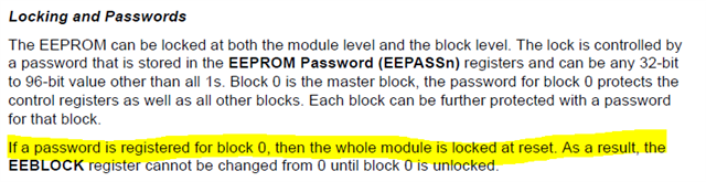

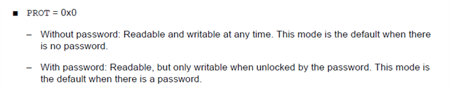

Internal EEPROM we configured with protection & password lock mechanism. Using PROT -0x0
We have loader & application. In application we wrote some value in EEPROM & locked the block. After reset if we read data from internal EEPROM it is getting 0xFF.
After reset If we do unlock with password only getting correct data  MAP_EEPROMBlockUnlock() .Is it expected behavior?
But as per data sheet if we use PROT as 0 read should work without password.
and in data sheet mentioned ,
After reset without MAP_EEPROMBlockUnlock() function read will work or not? Can you help on this?

  •  We configured internal EEPROM with protection & password lock mechanism. Using PROT -0x0.
     MAP_EEPROMBlockHide(block) function we used to hide only one block of data. We are not locking block0, But in some cases it made block 0 to lock. So while reading always getting data as 0xFF.
    As per data sheet PROT - 0 will allow to read with out unlock. In our application we are facing some issue after reset if use MAP_EEPROMBlockUnlock()  only getting correct data.
    Is it any specific reason the block 0 gets locks? How to avoid the above scenario?
    In our application block0 never used.
