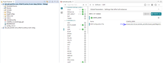

we are working on our custom board with AM2434 an LPDDR4 assembled.
During the initialisation of the LPDDR4, I run into a dead loop at line 123 in DDR_changeFreqAck() in ddr.c. Please refere to the picture below.

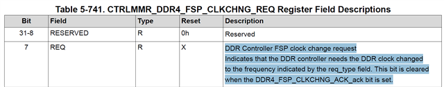

The loop waits untill Bit 7 of CTRLMMR_DDR4_FSP_CLKCHNG_REQ Register is non zero. Which only gets cleard by DDR4_FSP_CLKCHNG_ACK Register
Where does Bit 7 of CTRLMMR_DDR4_FSP_CLKCHNG_REQ get set during the initialisation?
From DDR_setFreq() I do not get an error message.
