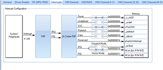

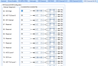

Hi all,
I am working with the development board Launchxk2-570lc43. Configure HalCoGen for use with freertos. Then, in the main code, I create two tasks, one to read the adc and the other to read the sci. In the configuration enable the SCI3 read interrupt, and its corresponding enablement in the VIM. The problem is that the interrupt is not working. That is, in the call to sci3HighLevelInterrupt I put a breakpoint while debugging it but it never enters.
Therefore, it never enters the sciNotification function that I implement in my code:

Below are the screenshots of the HalCoGen :
Please if you can tell me what I'm doing wrong?

  • Hi Pablo,
    Is the VIM table initialized in your project?
  • Hi Wang,
    I thing that during startup (from halcogen generated code), vim is getting initialized. is this correct or is there another way to initialize?

  • Hi Wang,
    I had a problem with the setting serial terminal. Now it's works. Thanks!. But, Do you always have to call the sciRecieve() before enable interrupt?.
        _enable_interrupt_();
        sciInit();
        sciEnableNotification(sciREG3, SCI_RX_INT);
        sciReceive(sciREG3,1,&c);
    If don't call sciReceive(), never enter in line for callback function in sci3HighLevelInterrupt:

  • Hi Pablo,
    Thanks for sharing the information. Yes, the sciReceive() should be called after RX INT is enabled.
