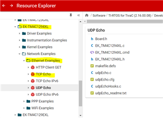

      - First run the TI-RTOS TCP echo example connecting to either a switch or a router directly. Will  both work? Log the wireshark captures.
    - Modify the example to use static address and connect to either a switch or a router?  You can unclick the box to obtain IP address automatically so you can enter your static address manually. Will both work? Log the wireshark captures.

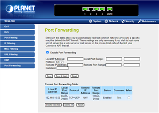

    Router TEST :
    MY device static IP : 192.168.10.53 : UDP PORT 20200 , TEST PC IP : 172.1.1.26
    Using port forwarding to send packet to my device.
    Wireshark pciture for UDP Echo TEST

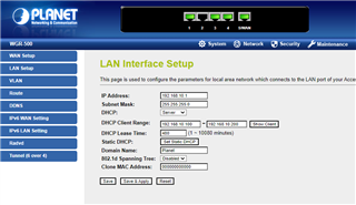

    My Router Settings :

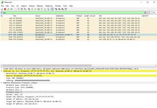

  • This is LAN side. Who has packes.
    It looks the issue is that the TM4C device isn't responding to the ARP requests from the router.
    Given the TM4C device does respond to the ARP requests from a PC when the TM4C and PC are connected via a switch I think the ARP requests from the router are different in some way.
    Can you use wireshark to inspect the difference in ARP requests from the working switch test and non-working router test?

  • This is the ARP request from router to TM4C device.
    This is ARP request and Response from TM4C Device when working on switch.
