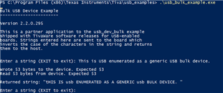

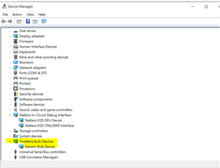

Hello, so I am trying use USB host port on micro controller when I am connecting to PC not the comport. i already tried the USB_bulk_example and after I run that the device shows as a generic bulk device in windows device manager. so I am trying to find a library or something for c# to recognize the launch board when it's on device mode
I'm not clear what you are looking for then. Are you trying the usb_dev_bulk example at C:\ti\TivaWare_C_Series-2.2.0.295\examples\boards\ek-tm4c123gxl\usb_dev_bulk? This is already a device mode mode example. When running, it will enumerate as a TivaWare bulk device. Do you see this in device manager?
There is an example host application from TivaWare download site at https://dr-download.ti.com/secure/software-development/software-development-kit-sdk/MD-oCcDwnGrsI/2.2.0.295/SW-USB-win-2.2.0.295.msi. Running this host application I see USB host (the PC) communicate with the USB device (the MCU). The source code for this host application can be found at C:\ti\TivaWare_C_Series-2.2.0.295\tools\usb_bulk_example. You can reference this host application to build your C# application.
