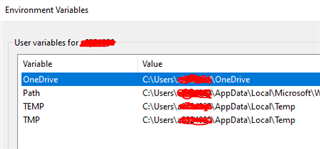

  • I compiled your code with TI ARM compiler: TI v16.9.11.LTS and TI v20.2.6.LTS, and I didn't see the issue.
    Please check if the TEMP and TMP environment variables are defined.
