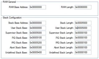

  • Hi UA
    The printf() takes bigger stacks, please adjust the Stacksize from HALCoGen GUI:
    HalCoGen->RAM->UserStack
    You can change the stack size manually defined in sys_core.asm:
    _coreInitStackPointer_
  • The printf() takes bigger stacks, please adjust the Stacksize from HALCoGen GUI
    The printf() is being called from inside a FreeRTOS task, so don't think adjusting the Stacksize in the HALCoGen GUI will make a difference.
    Think it is 3rd argument of the xTaskCreate function which needs to be increased to give the task which calls printf() a larger stack size:

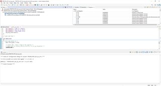

    I had the https://github.com/Chester-Gillon/E2E_example_projects/tree/master/TMS570LC4357_div_by_zero example which runs on a LAUNCHXL2-570LC43.
    Just updated the project to TI v20.2.6.LTS compiler, and when ran it the printf() output appeared on the CCS Console:
    Can't remember having to do anything specific when created the project to make printf() work.
    Can you try that project and see if the printf() works for you?

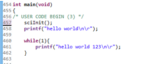

  • I have tried for long time, but I am not sable to se the data abort:
    int main(void)
         /* USER CODE BEGIN (3) */
         sciInit();
         printf("hello world\n\r");
         while(1){
                 printf("hello world 123\n\r");
    Would you please tell me more about your project?
    Does your printf() function print char to CCS console or to a UART terminal?
  • In my test, printf() outputs string to ccs console only.
