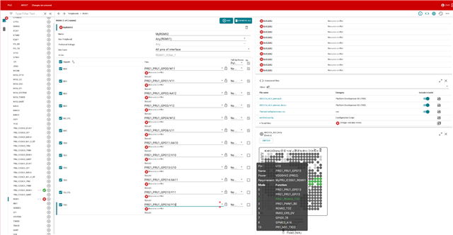

Hello Zackary,
sorry for not clear. Customer wants to design one HW/PCB for different applications. One application he wants to use CPSW for standard Ethernet and for the other application he wants to use ICSS for fieldbus Ethernet. So the CPSW and ICSS should use the same pins for the Ethernet transceiver so that he can use same PCB and don't have to use external MUX. What I know is that one port has overlayed pins between CPSW and ICSS.
Regards, Holger
Thank you for the additional clarification. This type of usage can also be confirmed with the SysConfig-PinMux Tool. Please see the screenshot below showing clear overlap between CPSW-RGMII1 and ICCSG1-RGMII2. Using these pins would allow customer to create singular HW design as you've mentioned (other solutions will also exist).
| Ball | CPSW | ICSS |
| W11 | RD0 (RGMII1) | RGMII2_RD0 |
| V11 | RD1 (RGMII1) | RGMII2_RD1 |
| AA12 | RD2 (RGMII1) | RGMII2_RD2 |
| Y12 | RD3 (RGMII1) | RGMII2_RD3 |
W12 |
RX_CTL (RGMII1) | RGMII2_RX_CTL |
| U11 | RXC (RGMII1) | RGMII2_RXC |
AA10 |
TD0 (RGMII1) | RGMII2_TD0 |
| V10 | TD1 (RGMII1) | RGMII2_TD1 |
| U10 | TD2 (RGMII1) | RGMII2_TD2 |
| AA11 | TD3 (RGMII1) | RGMII2_TD3 |
| Y11 | TX_CTL (RGMII1) | RGMII2_TX_CTL |
| Y10 | TXC (RGMII1) | RGMII2_TXC |
