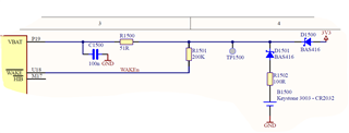

WAKE and HIB pins are connected as follows:

     Looking at your schematic, I'm interested to know what is your mechanism of waking up the device. I see you connect WAKEn pin to the battery and power supply. Is that correct? Will WAKEn pin ever go low? WAKEn is a active low signal to wake up the device when the device is in hibernate mode. There are other methods to wake up the device such as to use I/Os to wake up the device from hibernate. Is that what your method is?

    WAKEn pin is not intended to go low. The device is not supposed to go to actually hibernate during the runtime. Whole idea of the using hibernate module is to use the real time clock and always have a correct date time through using HibernateCalendarGet function. (Of course after setting it in a first time use)

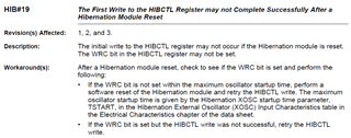

  • Hi Erman,
      I find this errata that may be related to your observation. Can you try the workaround as mentioned?

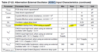

      The WRC bit is a read-only bit. You cannot manually overwrite the bit. Can you please try the workaround as suggested in the errata which is to reset the hibernate module after the oscillator startup time has elapsed if the WRC bit does not change to a 1. After the hibernate module reset, perform a write again. The oscillator startup is about 600ms as stated in the datasheet.

    The code is hanging in the below function where it is waiting for the WRC bit to become 1. Check the source file at C:\ti\TivaWare_C_Series-2.2.0.295\driverlibhibernate.c. You can copy this file to your local project directory if you want to modify it without rebuilding the driverlib.lib. You will need to modify the code so the code will exit out of the while loop either after 600ms or after the WRC bit become 1. If the errata workaround still does not work then you may not have hit the errata but rather something else that I don't really know the cause. As you mentioned, you only see 2 out of 28 with unexpected behavior. The problem seems to be more hardware related.
